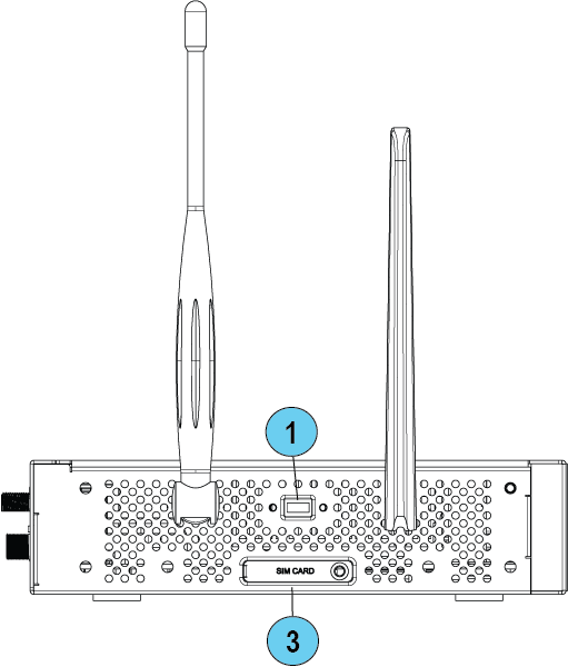

Side 1 |
Side 1 |
Side 1 |

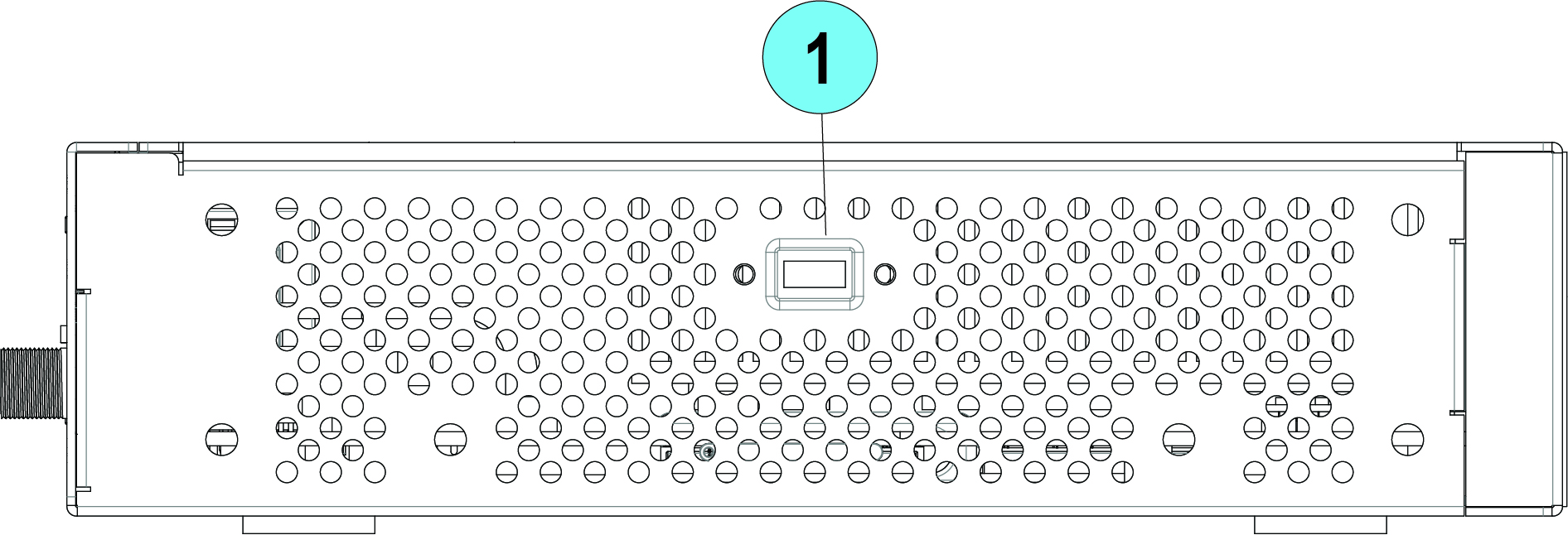

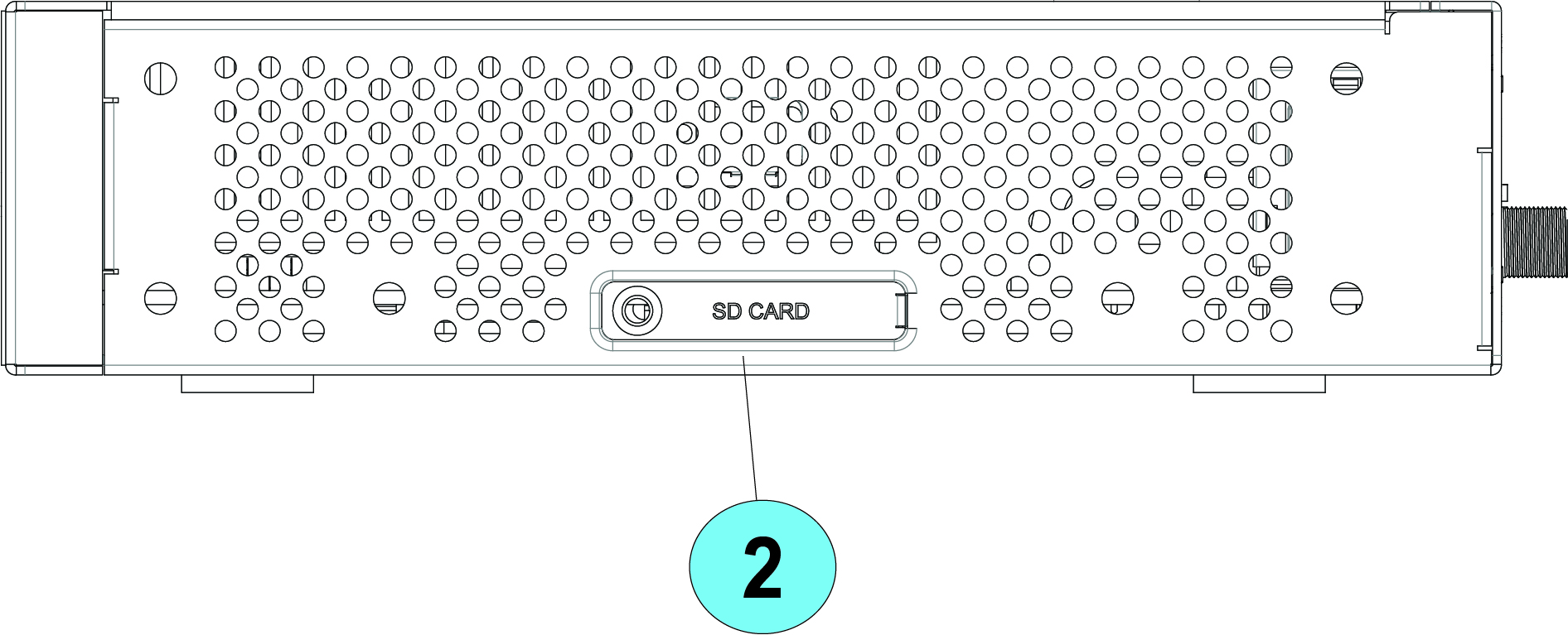

Side 2 |
Side 2 |
Side 2 |
Key |
Item |
Description |

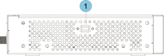

1 |
Anti-theft slot |
Insert anti-theft cable here. Use Kensington and Sunbox TL-623M cable as a reference. |
2 |
SD slot |
Insert micro-SD card here. |
3 |
Dual SIM slot |
Insert one of two SIM cards here (Cellular models only):
SD Card Notes:
Micro-SD card supports the format
ext4, up to 256GB size. -
Insert or remove SD card only when the appliance is powered down.
While inserting the micro-SD card, make sure the golden pins are facing upward:
