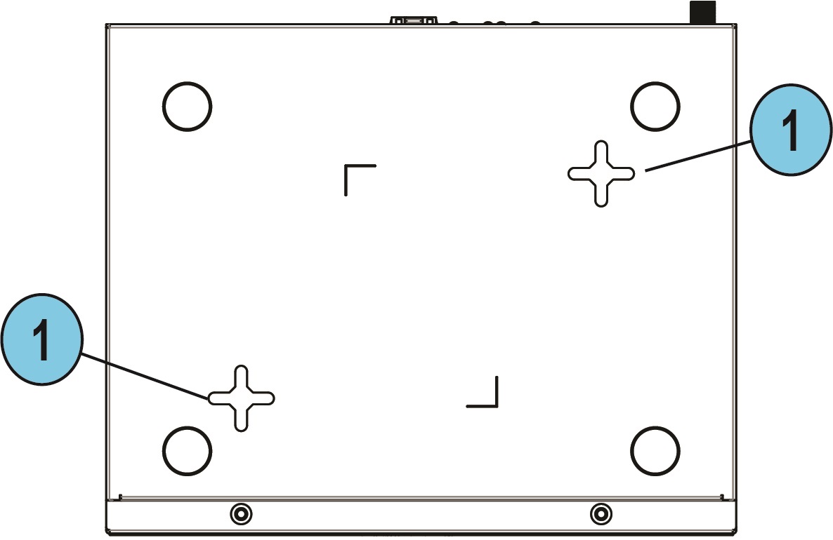

Wall Mounting
To mount the appliance to the wall:
  1. Place the wall-mount sticker on the wall and drill two holes for the screws.
  2. Insert the 2 screw anchors in the wall.
  3. Attach the 2 screws in the accessory kit (M4*6) to the wall.
  4. Mount the appliance and verify the 2 screws are fastened well to the appliance.
Key
Item
Description
1
Holes on the bottom of the appliance
Attach screws here
