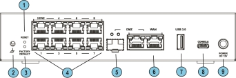

Back Panel
Wired
WiFi
WiFi-LTE
WiFi-Cellular
Key
Item
Description
1
Reset
Short press resets the system but does not remove any user parameters.
2
Ground screw
Functional grounding.
3
Factory default
Press the button continuously for 12 seconds to restore the appliance to its factory default.
All user parameters previously configured are removed.
4
LAN ports
LAN ports 1-8.
LAN port 2/Sync.
Support 10/100/1000 MbE.
5
DMZ port
(combo RJ45 or
DMZ fiber SFP port)
WAN combo port (RJ45 or DMZ fiber).
Only one can operate at a time once plugged in and connected.
Once connected, you must remove it to activate the other port.
The LEDs above indicate connection and speed per connection.
Each uses its own LEDs.
The SFP supports 1 GbE speed, short and long range. See catalog for P/Ns.
6
RJ45 WAN port
WAN port RJ45 (on the right) - supports 10/100/1000 MbE.
7
USB port 3.0 (Type-A)
USB port 3.0 for software download.
8
Console
Plug in the serial console cable here. Baud rate: 115200.
9
Power cord socket
Plug the power adapter cord in here.
10
WiFi Antennas
In WiFi, WiFi-Cellular, and WiFi-LTE models - 4 total
11
LTE Antennas
In WiFi-Cellular models - 2 total
12
5G Antennas
In WiFi-LTE models - 4 total
