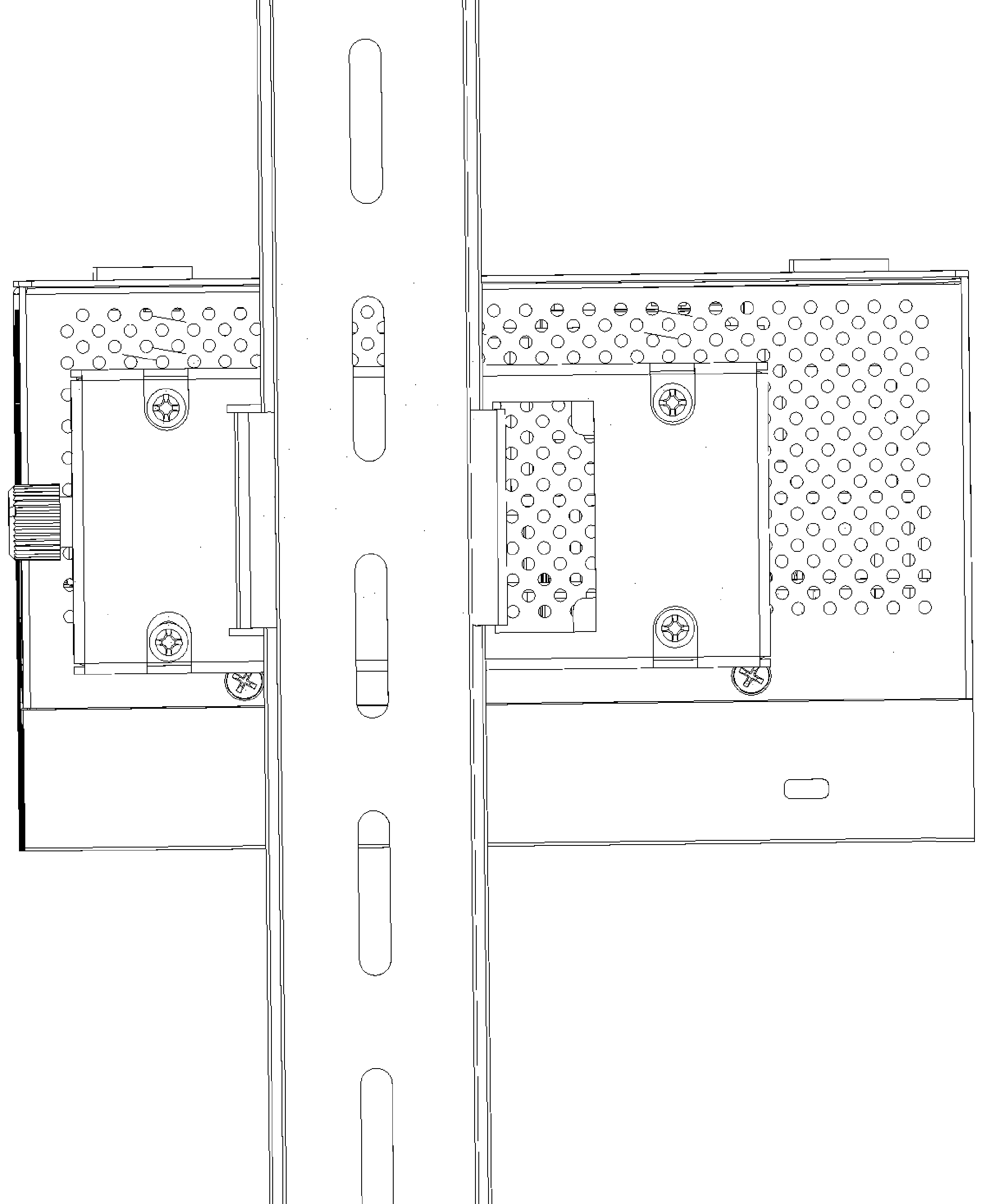

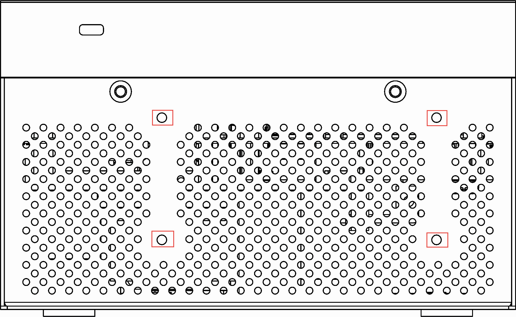

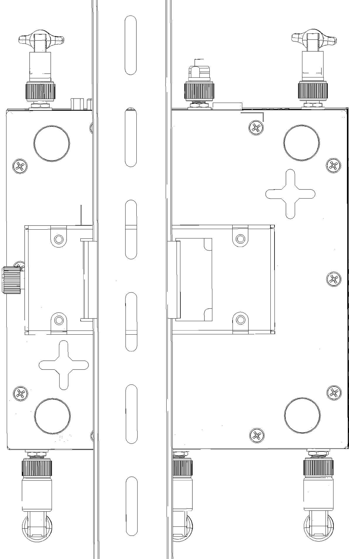

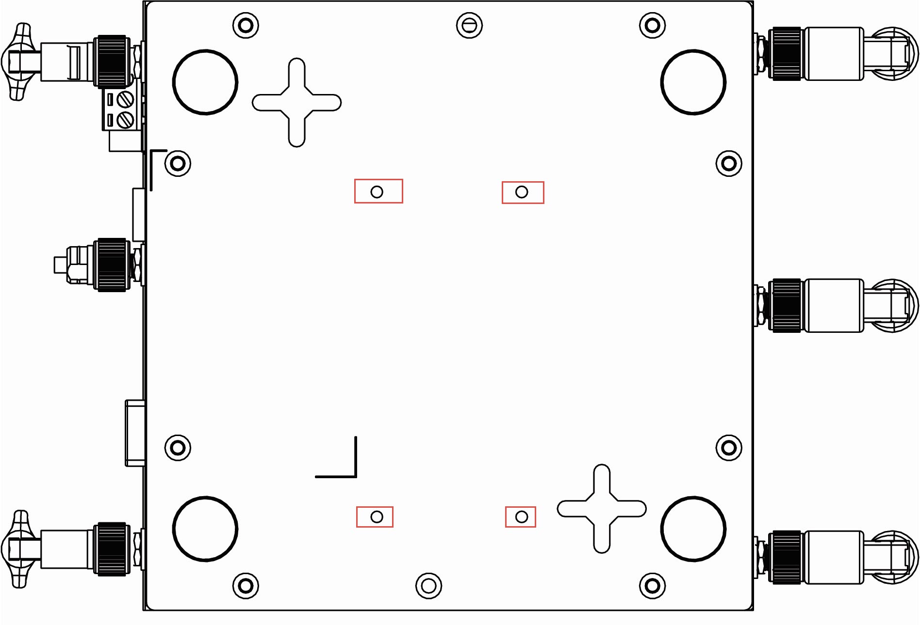

To mount the appliance using the DIN rail kit:
Attach the DIN rail kit with the 4 M3 screws which came in the box. Depending on the model, the DIN rail mount holes are located on the back panel or bottom panel or both.
Back panel
Bottom of the appliance
In the 1570R WiFi-LTE model, use the DIN rail mount holes located on the bottom panel :
