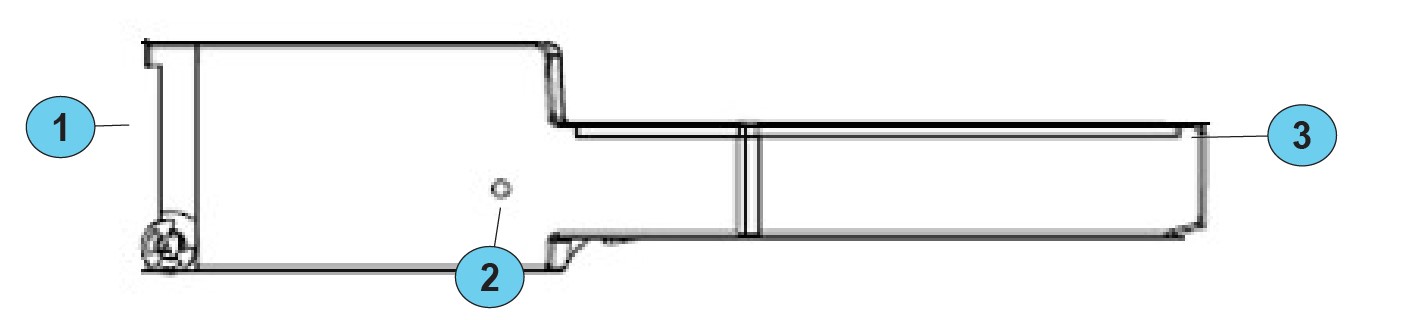

Key |
Item |
Description |
1 |
RJ45 port |
Attach the cable here. |
2 |
LED |
Indicates the DSL connection status. |
3 |
SFP connector |
Insert this end into the appliance DMZ port. |
Cable type depends on the model:
CPAC-1500-TR-DSL delivered with RJ45 to RJ11, 1.8m cable
CPAC-1500-TR-DSL-B delivered with RJ45 to TAE, 2m cable
Note - The RJ45 port on the transceiver uses only pins 4 and 5 for an analog input. No other pins are used. |
