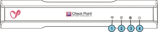

Front Panel
Note - There is only one set of LEDs. These LEDs show different colors depending on what activity is occurring.
Table: LEDs
Key
Item
Icon
Description
1
WiFi LED
(WiFi models only)
  • Off - WiFi off
  • Blue - WiFi on and operates normally
  • Red - WiFi error/alert
2
Management LED
  • Off - No management
  • Colors - See below
3
Internet LED
  • Off - No internet connection
  • Blinking Blue - Trying to connect to the internet.
  • Blue - Connected
  • Blinking Red - Connection failure
4
Power LED (Status)
  • Solid Blue - Normal operation
  • Blinking Blue - Boot in progress and installing firmware. After the process completes, the LED is solid blue.
  • Red - Error/Alert
Note - This LED is red when the appliance is first turned on.
