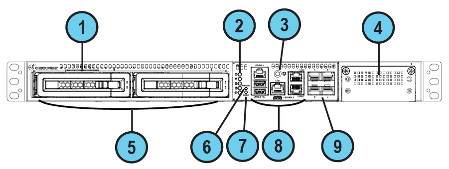

Smart-1 700-S and Smart-1 700-M Appliance Hardware
Front Panel
Item
Component
Description
1
Service tag
A slide-out card that identifies the appliance and shows its serial number and MAC address.
It also contains a QR code that you can scan to view documentation.
2
System LEDs
See Front Panel System LEDs.
3
ESD grounding point
When you service the appliance, connect an ESD strap to this point.
4
Expansion line card
In the Gaia OS, the ports on this expansion line card are assigned the names eth1-01, eth1-02, and so on up to the last port.
Port speeds for supported line cards are: 1/10/25/G.
5
2 storage devices
Numbered from left to right: 0 to 1
  • Activity LED (top LED on the storage device):
    • Off - No storage device activity
    • Blinking green - Storage device activity
  • Status LED (bottom LED on the storage device):
    • Off - Power is off
    • Steady green - Storage device is powered
6
Locator button
Turns the location beacon LED on and off in the appliance.
7
Reset
Insert a pin for 5 to 8 seconds to perform a hardware reset.
8
Appliance ports
See Front Panel Ports - Use these ports to connect to the appliance.
9
On board 1/10G Fiber ports
In the Gaia OS, these ports are assigned the names from eth1 to eth4.
See Front Panel On-board Port LEDs.

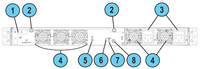

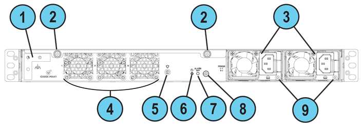

Rear Panel
Smart-1 700-S
Smart-1 700-M
Item
Component
Description
1
Metal grounding plate
Used to connect the grounding lug.
2
Cover screws
Loosen screws to remove the cover of the appliance.
3
Power supply units
In Smart-1 700-S, two fixed power supply units (PSU). Each PSU connects to an electric outlet.
In Smart-1 700-M, two PSUs that you can hot swap. Each PSU connects to an electric outlet.
You can use the cable restraints to avoid accidental removal of the power supply cable.
The PSUs are numbered from left to right in the OS as "Power Supply #1" left) and "Power Supply #2" (right).
See PSU Configuration and Monitoring.
4
Cooling fan units
In Smart-1 700-S, units are numbered from left to right: 1, 2, 3, 4, 5
In Smart-1 700-M, units are numbered from left to right: 1, 2, 3.
When checking the hardware sensors in the CLI, they are referred to as "SYS_FAN1", "SYS_FAN2", and "SYS_FAN3".
See Cooling Fan Units Naming Convention.
5
ESD grounding point
When servicing the appliance, connect an ESD strap to this point.
6
Location LED
  • Off - Location beacon is turned off
  • Blinking blue - Location beacon is turned on in Gaia Portal, Gaia Clish, or by pressing the Locator button on the front panel
Note - Turn off the Location beacon LED the same way you turned it on.
7
Alarm Off button for power supply units
An alarm sounds if:
  • A power supply cable is not connected to the outlet
  • One of the PSUs is not fully inserted or failed
Press this button to turn off the alarm. Note that this button is functional immediately after powering up the appliance.
8
Main power button
When the appliance is turned off, turns the appliance on.
When the appliance is turned on, pressing and releasing the button starts an orderly shutdown process. Alternatively, holding the button for 4 seconds forces a machine shut down.
9
LED indicator for each AC power supply unit in Smart-1 700-M appliances
  • Off - No power cord is connected to any of the PSUs in the appliance.
  • Green - Appliance is turned on.
  • Blinking green - Power cords are connected to all PSUs, but the appliance is turned off.
  • Amber - No power cord is connected to the PSU, but other PSUs in the appliance are connected to a power cord or there is a power supply critical event causing a shutdown; failure, OCP, OVP, Fan Fail, over temp.
  • Blinking amber - Warning about a hardware issue (high temperature, high power, high current, slow fan) that may lead to an issue with the PSU.

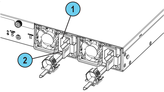

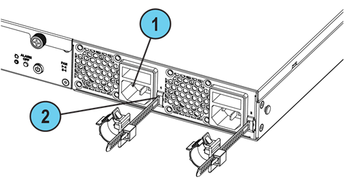

Installing the Power Cable Restraint
You can use the power cable restraint to prevent accidental removal of the power cable.
Item
Description
1
Restraint anchor
2
Cable loop
3
Restraint strip tab
4
Restraint strip
Smart-1 700-S
Smart-1 700-M
Item
Description
1
Power supply inlet
2
Restraint strip slot

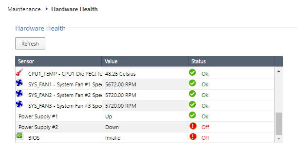

These notifications appear in the event of a BIOS failure:
  • The appliance's Alert LED on the front panel blinks red.
  • The Gaia Portal > Maintenance > Hardware Health page shows that the BIOS sensor is Invalid and its status is Off.
    Example:
  • An SNMP trap message is sent (if the biosFailure trap was configured in the Gaia Portal or Gaia Clish).
    Example:
To recover from a BIOS failure, see sk108517 or contact Check Point Support. The appliance is fully functional until the BIOS recovery is completed. Note that it can take a few minutes for it to boot in BIOS recovery mode.

When a PSU functions correctly:
  • The PSU LED is green
  • The Alert LED is not blinking due to a PSU issue (might still be blinking due to other errors)
  • There is no SNMP alarm.
When a PSU does not function correctly:
  • The PSU LED is amber
  • The Alert LED is blinking due to a PSU issue
  • An SNMP alarm is sent.

    Hardware Information
    Name              Value   Unit      Type    Status   Maximum   Minimum
    Power Supply #1   Up      Up/Down   Power   0        Up        Down
    Power Supply #2   Up      Up/Down   Power   0        Up        Down
    Where:
    Column
    Description
    Name
    Power Supply #1 - The PSU in the top PSU slot.
    Power Supply #2 - The PSU in the bottom PSU slot.
    Value
    Up - The PSU slot contains a PSU and is up.
    Down - The PSU slot contains a PSU but it is not connected to a power source.
    Unknown - There is nothing in the PSU slot.
    Unit
    Up/Down - PSUs are either Up or Down.
    Type
    Power - The sensor type is "power supply".
    Status
    0 - No problems found.
    1 - Error.
    Maximum
    Minimum
    The maximum and minimum thresholds.
    PSUs are only measured as Up or Down.
