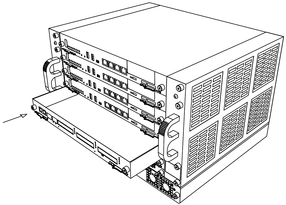

Installing SSMs in the 41000 Chassis
To install a Security Switch Module (SSM):
  1. Open the latches at the left and right of the SSM.
  2. Slide the SSM into the allocated slot.
  3. Fasten the latches.
  4. Tighten the screws.
