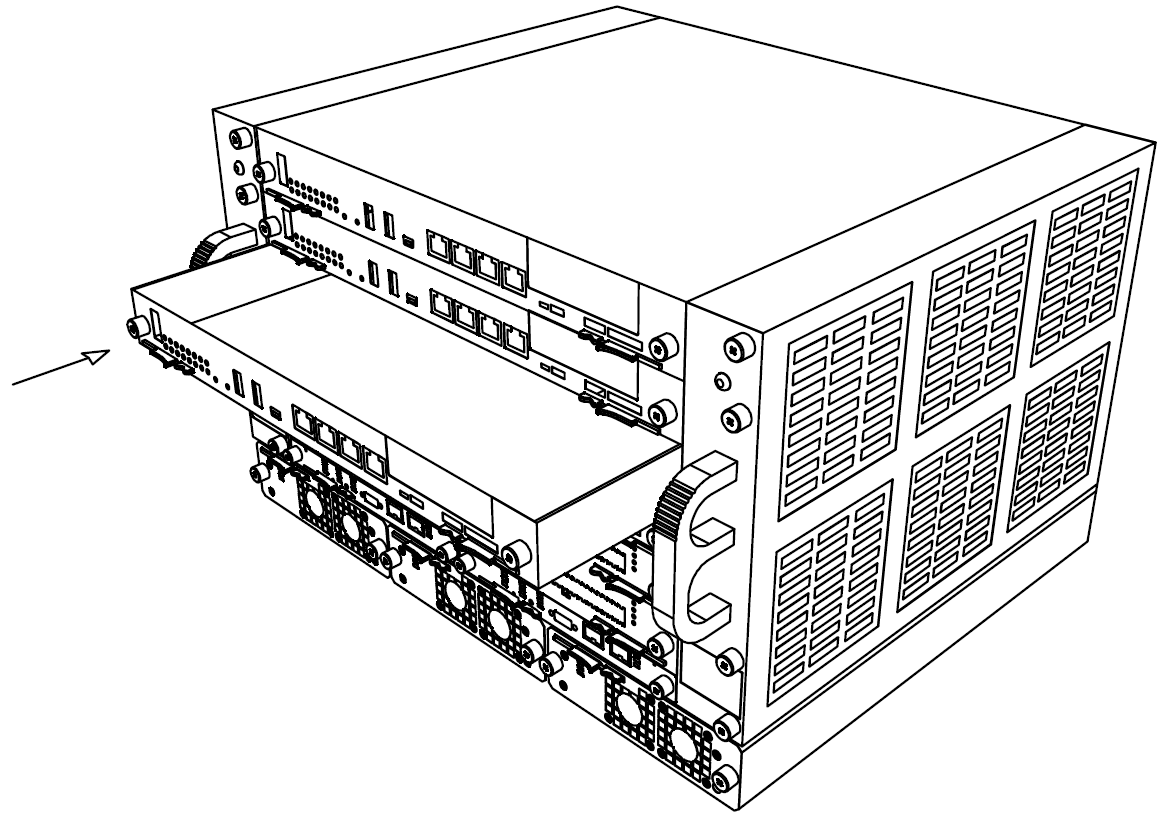

Installing SGMs in the 44000 and 41000 Chassis
To install a Security Gateway Module (SGM):
  1. Open the latches at the left and right of the SGM.
  2. Make sure the SGM is located correctly on the Chassis rail.
  3. Slide the SGM into the allocated slot.
  4. Fasten the latches.
  5. Tighten the thumb screws.
