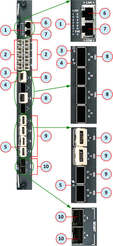

SSM440 Security Switch Module
Item
Name
Description
1
LINK
LEDs that show the status of the FI ports that are denoted as (2).
2
1-7, SYNC
8 x 1/10GbE SFP/SFP+ FI ports.
3
LED that shows the Out of Service status.
4
LED that shows the Power status.
5
LED that shows the Hot-swap status of the SSM.
6
LAN
10/100/1000BASETX RJ45 Ethernet port used to perform chassis management and software upgrade through direct connection to the chassis.
7
COM
1 RJ45 port for direct access through console.
This port uses RS232 level signaling and is configured for 9600 Baud.
This port is an EIA232 VT-100 compatible.
TX and RX lines are protected for 15kV ESD.
8
100G
QSFP28/QSFP+ FI ports.
One of these:
9
40G
QSFP+ FI ports.
One of these:
  • 4 x 40GbE (using 40Gbe QSFP+) ports.
  • 16 x 10GE (using 4 x 40Gbe QSFP+ and MPO breakout cable) ports.
10
MGMT
2 x 1/10GbE SFP/SFP+ BI ports.
