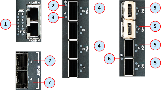

SSM440 Security Switch Module LEDs
Item |
LED |
Status |
Description |
1 |
LINK 1, 2, 3, 4, 5, 6, 7, SYNC |
On (Normal) |
Traffic in the SSM flows correctly. |
Off |
Traffic does not flow in the SSM. |
2 |
Out of Service
Red |
SSM is out of service. |
Off (Normal) |
SSM hardware works normally. |
3 |
Power
On (Normal) |
Power on the SSM is on. |
Off |
Power on the SSM is off. |
4 |
25 100G 33 100G |
On (Normal) |
Traffic flows correctly through the QSFP28/QSFP+ FI port. |
Off |
Traffic does not flow through the QSFP28/QSFP+ FI port. |
5 |
9 40G 13 40G 17 40G 21 40G |
On (Normal) |
Traffic flows correctly through the FI QSFP+ port. |
Off |
Traffic does not flow through the FI QSFP+ port. |
6 |
Hot-swap status
Blue |
SSM can be safely removed. |
Blue blinking |
SSM is going to the Standby mode. Do not remove. |
Off (Normal) |
SSM is in the Active mode. Do not remove. |
7 |
3 MGMT 4 MGMT |
On (Normal) |
Traffic flows correctly through the SFP/SFP+ BI port. |
Off |
Traffic does not flow through the SFP/SFP+ BI port. |
