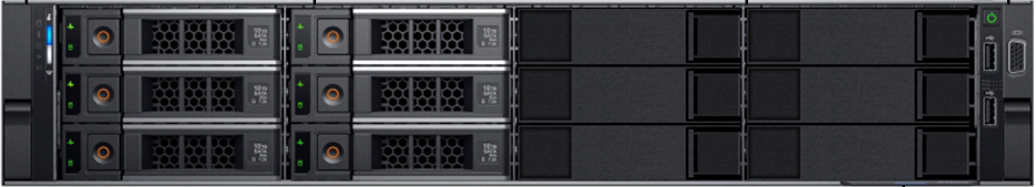

Numbering of the Disk Slots on the Front Panel
Smart-1 6000-L/6000-XL Front Panel
Slot 0:
Disk
Slot 3:
Disk
Slot 6:
Optional
Slot 9:
Optional
Slot 1:
Disk
Slot 4:
Disk
Slot 7:
Optional
Slot 10:
Optional
Slot 2:
Disk
Slot 5:
Disk
Slot 8:
Optional
Slot 11:
Optional
Note - See the slot numbers below the bottom row of disk slots on the appliance.

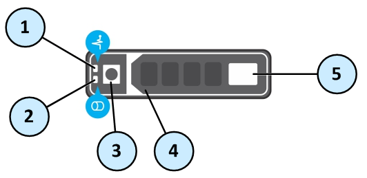

Disk Carrier
Item
Description
1
Status indicator LED.
Shows the power condition of the disk.
For LED patterns, see the table below.
2
Activity indicator LED.
Shows whether the disk is currently in use or not.
3
Release button.
4
Release handle.
5
Disk.
Status Indicator LED Patterns
Status Indicator
LED Pattern
Disk Condition
Steady green
Disk is online.
Flashes green twice per second
Identifying disk or preparing disk for removal.
Blinks green, amber, and then turns off
Predicted disk failure.
Blinks amber four times per second
Disk failed.
Blinks green slowly
Disk is rebuilding.
Blinks green for three seconds, blinks amber for three seconds, then turns off after six seconds
Disk rebuild stopped.
Off
Disk is ready for insertion or removal.
The status indicator LED remains off until all disks are initialized after the system is turned on. Disks are not ready for insertion or removal during this time.
