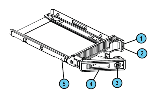

Removing a Storage Device
Item |
Description |
1 |
Activity LED
2 |
Power LED |
3 |
Key lock (2 keys come inside the storage device unit's box) |
4 |
Ejector handle |
5 |
Storage device casing |

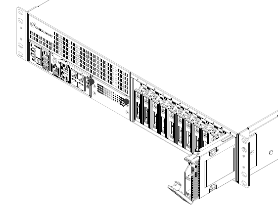

To remove a storage device:
Open the lock with the provided key.
Pull the ejector handle down.
The storage device pops out.
Hold the ejector handle and gently pull the storage device casing to remove the storage from the appliance.
Important - Be careful when you pull the ejector handle. If you pull too hard on the ejector handle, it can break off from the storage device casing. |

Insert the replacement storage device into the appliance.
To install a storage device:
Hold the storage device casing and insert the replacement storage device into the slot.
Push the ejector handle to close it.
The storage device clicks into position.
Lock the storage device with the provided key.
