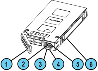

Removing a Storage Device
Item |
Description |
1 |
Ejector handle |
2 |
Release latch |
3 |
Activity LED
4 |
Power LED
5 |
Key lock (2 keys come inside the storage device unit's box) |
6 |
Storage device casing |

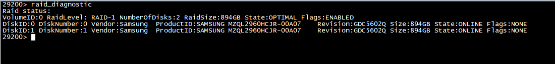

To monitor the RAID status of the storage devices from the CLI:
Log in to the appliance and open a command line.
Run:
raid_diagnosticThis shows data about the RAID and storage devices, with the percent of synchronization completed.
DiskID 0is the top storage device.DiskID 1is the bottom storage device.When you first turn on the appliance, the RAID state (in the VolumeID line) shows
DEGRADED(this indicates that the drives are not synchronized). The DiskID:0 state showsONLINEand the DiskID:1 state showsINITIALIZING.After the RAID is synchronized, the RAID state (in the VolumeID line) shows
OPTIMAL(this indicates that the drives are synchronized). The DiskID:0 and DiskID:1 states showONLINE.This example shows that the storage devices are fully synchronized (disk sizes and vendor may vary).
