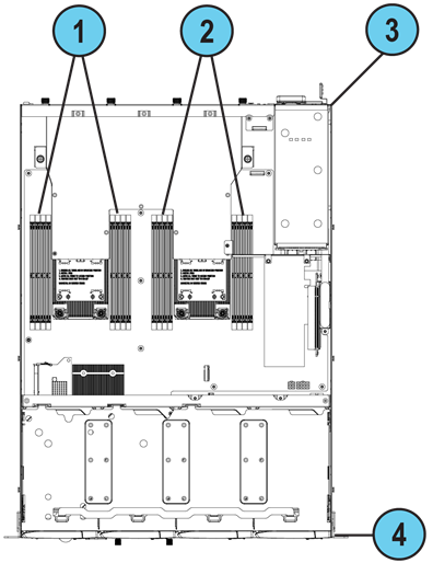

About DIMM Sockets
Item |
Description |
1 |
CPU0 DIMM sockets |
2 |
CPU1 DIMM sockets |
3 |
Appliance rear panel |
4 |
Appliance front panel |
The memory sockets are situated to the left and right of the CPU units. Note - In the appliance configuration diagrams:
The view shown is always from above the appliance.
The front panel of the appliance is always at the bottom of the diagram.
