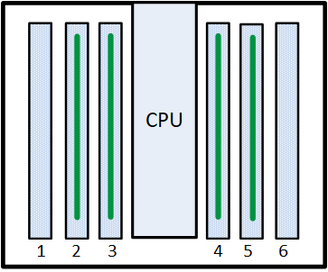

MLS200 DIMM Configuration
The MLS200 appliance has a default memory configuration of 64GB with four16 GB DIMMs in memory slots 2, 3, 4, and 5.
64GB Memory Configuration
Top View
(Front panel of the appliance is at the bottom of the diagram)
To upgrade to 96GB, use six 16GB DIMMs in all memory slots.
