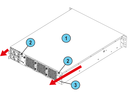

  5. Remove the top cover from the appliance.
To remove the top cover:
  1. Unscrew the cover screws (number 2 on the diagram below).
  2. Pull the top cover back in the same direction the red arrows are pointing on the diagram.
  3. Pull the cover up to remove it completely.
Appliance top cover removal
Item
Description
1
Appliance cover
2
Appliance cover screws
3
ESD grounding point

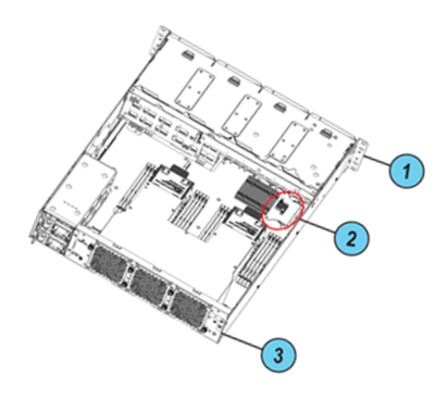

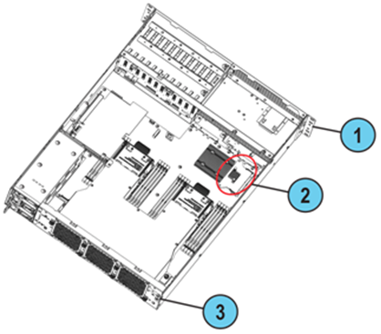

Finding the LOM Card Socket
The diagram shows the location of the LOM Card in the appliance.
Smart-1 7000-UL and Smart-1 7000-XL
Smart-1 7000-L

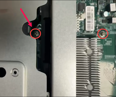

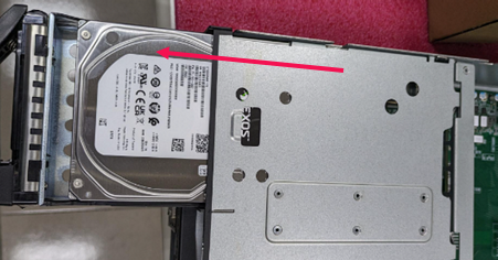

Important - Before you can remove the LOM Card in Smart-1 7000-L Appliances, you first have to remove storage device #0 that covers one of the LOM Card screws.
Legend
Item
Description
1
Front panel
2
LOM Card (in socket)
3
Rear panel
Removing the Storage Device in Smart-1 7000-L Appliances
Make sure that you prepare the appliance before you remove the storage device.
To remove storage device #0:
  1. Pull out storage device #0 from the appliance chassis to access the LOM Card screw beneath it
    The LOM screws are now accessible.
  2. After you have completed the required tasks, reinsert the storage device.

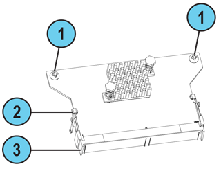

Removing the LOM Card
Make sure that you prepare the appliance before you remove the LOM Card.
Legend
Item
Description
1
Screw
2
Socket locking levers
3
Socket
To remove the LOM Card:

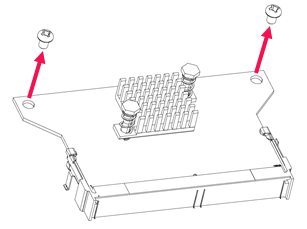

  1. Remove the screws located in the corners of the LOM Card.
    Note - We suggest that you use a magnetic screwdriver to remove the screws on the Smart-1 7000-L appliance.

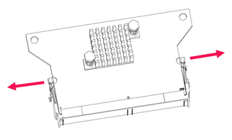

  2. Pull the socket locking levers outward (away from the card edges). Use a tool (such as tweezers) if necessary to move the socket levers on the LOM Card on the Smart-1 7000-L appliance.
  3. Lift the end of the card and pull it out of the socket.
