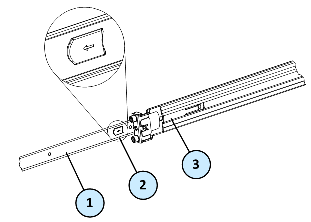

Attaching the Inner Appliance Rails

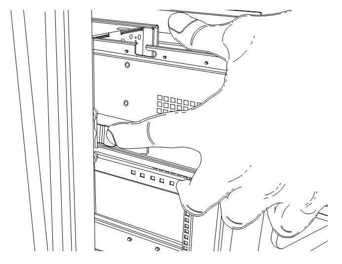

The outer rack rail section and the inner appliance rail section come as one unit when you open the box.
Before you can attach each appliance rail to the side of the appliance, you must remove the inner appliance rails from the outer rack rails.
To remove the inner appliance rail from the telescopic rail unit:
  1. Extend the inner appliance rail from the outer rail until the rails locks in place.
  2. Press the inner rail release latch, as shown, and pull the inner appliance rail straight out.
    Item
    Description
    1
    Inner rack rail
    2
    Release latch
    3
    Outer appliance rail
  3. Repeat steps 1 and 2 for the other telescopic rack rail unit.

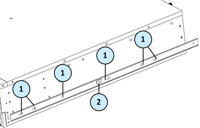

To install the inner appliance rails to the appliance:
  1. Place the appliance rail on the side of the appliance and make sure:
    • The release latch is facing away from the appliance
    • The arrow on the release latch points to the front of the appliance
    • The appliance rail is longer than the appliance
  2. Install the appliance rails to the side of the appliance with the six provided screws. Refer to the below appliance rail image.
    Note - Do not over-tighten the screws. Check Point recommends that you leave the rail mounting screws loose until the server is completely installed. This eases installation by preventing binding of the server in the rack.
  3. Do steps 1 and 2 again to install the appliance rail on the other side of the appliance.
Item
Description
1
Appliance rail screws
2
Release latch (press this latch to remove the appliance from the rack)

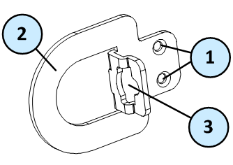

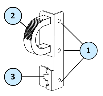

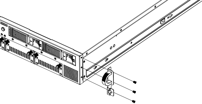

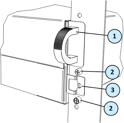

Attaching the Ear Mounts
Attach the ear mounts to the left and right side of the front of the appliance to allow:
  • Easy pulling in and pulling out of the appliance while it is in the rack using the extraction handles
  • Locking the appliance into the rack using the rack mounting screws
16000, 16200, 26000, and 28000
Ear Mount Bracket
16600HS and 28600HS
Ear Mount Bracket
Item
Hardware Description
Use
1
Holes for ear bracket screws
Attaches ear mount to the appliance
2
Extraction handle
Pulls appliance away from the rack
3
Rack post mounting hole for the rack mounting screw
When the screw is fastened, the appliance cannot be pulled out of the rack

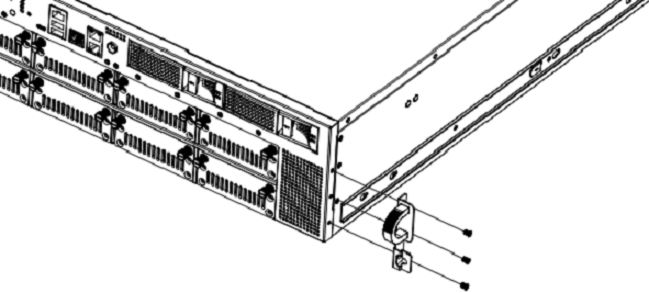

To attach the ear mounts to the appliance:
  1. Place the ear mount on the side of the appliance near the front panel.
  2. Attach the ear mount to the appliance using the ear bracket screws.
    • 16600HS and 28600HS: Use two screws
    • 16000 and 16200: Use three screws
    • 26000 and 28000: Use three screws
  3. Do steps 1 - 2 again for the other side of the appliance.

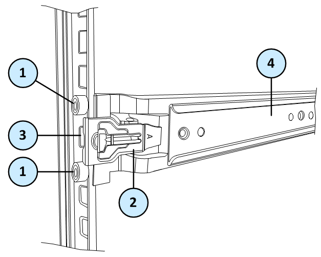

Attaching the Outer Rack Rails
Attach the outer rack rails to the rack. Make sure that you have the two rack rails ready.
Item
Description
1
Rack rail screws (attached to the end of the rack rail)
2
Securing clip
3
Screw hole for ear mount screw
4
Rack rail
To attach the outer rails to the rack:
  1. If your rack has round holes, remove the screws from the end of the rack rail and replace them with the round hole pins.
  2. Align the front end of the outer rail with the hole number.
    • The front securing clip is marked with the letter A.
    • Make sure that the securing clip faces the inner part of the rack.
  3. Press the securing clip and connect the outer rail to the rack.
    • For square-hole racks: Insert the screws into the rack holes.
    • For round-hole racks: Reattach the screws that you removed to the rack. Tighten the screws.
  4. Do steps 1 - 3 again to attach the rear end of the outer rail to the rack.
    The rear securing clip is marked with the letter B.
  5. Use an ear mount screw (with washer) to secure the rear end of the outer rail to the rack.
  6. Do steps 1 - 5 again for the other outer rail.

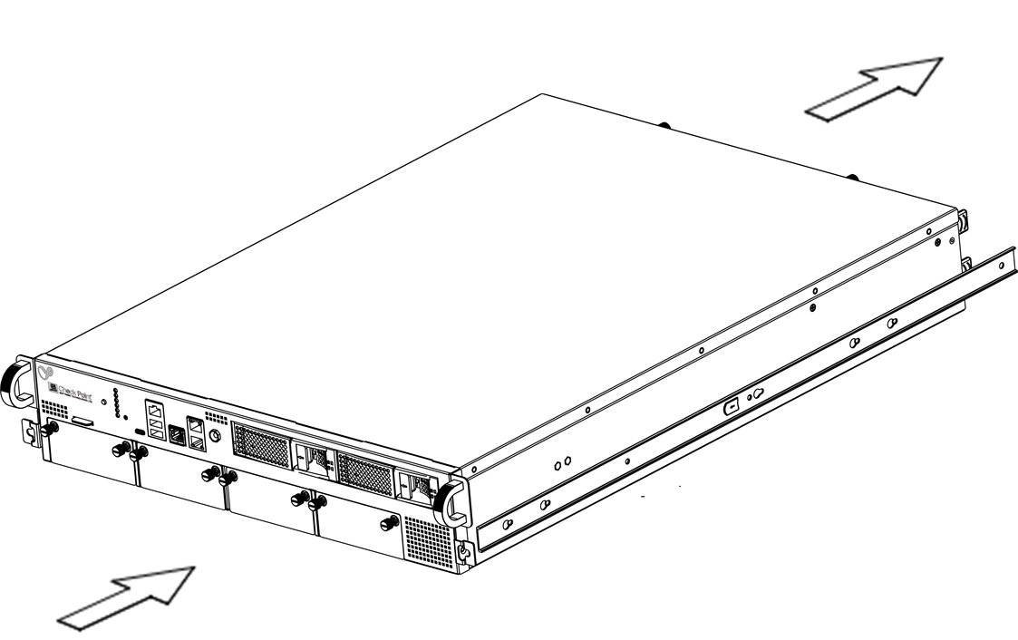

Installing the Appliance in the Rack
Install the appliance in the telescopic rails in the rack.
Important - We recommend that at least two people install the appliance in a rack to prevent injury, or damage to the appliance.
Important - Do not attempt to lift, drag, or otherwise move the appliance using the handles on the power supply units.
To install the appliance in the rack:
  1. Align the appliance rails to be level with the rack rails.
  2. Move the appliance into the rack as far as it can go.
  3. Slide the appliance in and out of the rack several times to allow the rails to position properly.
    Tighten all of the rail mounting screws.
  4. For each ear mount, use a rack mount screw to secure it to the rack and make sure that the appliance cannot move. This disables the telescopic rails.
    Use the rack post mounting hole that is between the rack rail screws (see item 3 in the next figures).
16600HS and 28600HS
Item
Description
1
Extraction handle
2
Rack rail screws
3
Rack post mounting hole for rack mount screw
